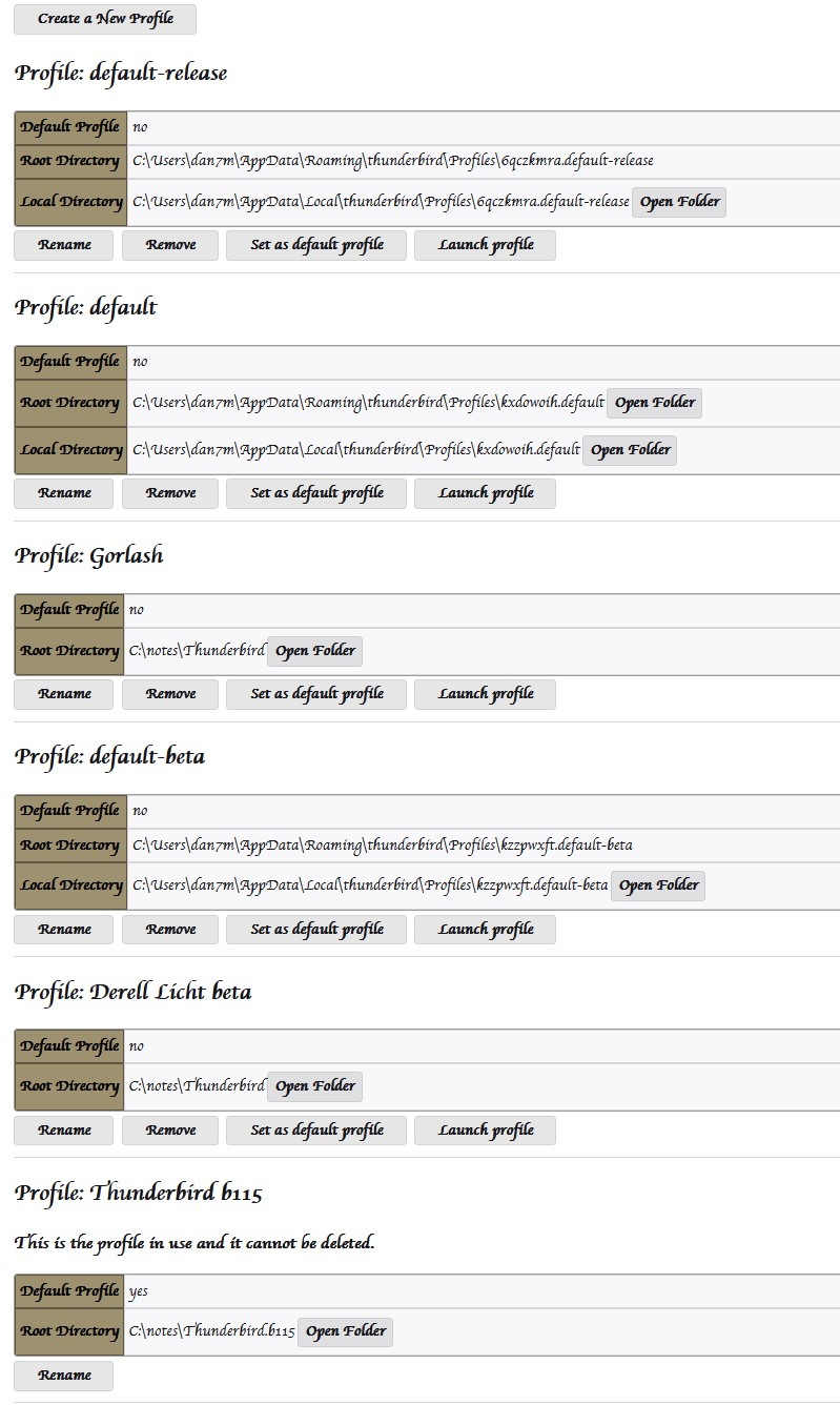

When I look at About Profiles, I actually see *three* profile folders listed:
Profile: Gorlash: (default: no) c:\notes\Thunderbird
Profile: Derell Licht beta: (default: no) c:\notes\Thunderbird
Profile: Thunderbird beta (default: no) c:\notes\Thunderbird.beta (note that this folder does not exist)
Profile: Thunderbird b115: (default: yes) c:\notes\Thunderbird.b115
Is there something that I could do to consolidate all of this into just one folder? I don't even *know* what those Gorlash and Derell Licht profiles refer to... Yes, those are both usernames that I use online, in various contexts, but as far as I know, I don't use them in Thunderbird...
Q1: Can I just delete those other profiles where default is NO ?? Q2: Why is c:\notes\Thunderbird still getting periodic updates, even though those profiles are not default??

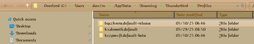

I *did* go to the %APPDATA%\Thunderbird\Profiles\ path that your link suggested, and I *do* see three profiles there... and two of them are updated on 05/23/25, same as the c:\notes\Thunderbird folder... So I'm guessing that those are the Derell Licht beta and Gorlash profiles that I was wondering about... I still don't know why they are even there, but maybe it just doesn't matter and I can delete them...

Okay, here are those images... I'm including both an image of the About Profiles page, as well as an image of the contents of %APPDATA%\Thunderbird\Profiles\
I would note that I have already deleted one profile from About Profiles page; This listed its root directory as c:\notes\Thunderbird.beta, a folder that does not exist.
The Profiles that I am questioning are 'Gorlash' and 'Derell Licht beta' ... They are pointing to a different folder than the active profile 'Thunderbird b115' ...
So permit me to re-state my original question: I note that c:\notes\Thunderbird.b115 gets updated every time something changes in Thunderbird, which I understand because it is the active profile.
However, the folder c:\notes\Thunderbird, which is root folder for 'Gorlash' and 'Derell Licht beta' profiles, only gets updated about once a week. Neither of these profiles is default, so I don't know why they are getting updated now and then...
I would like to delete that folder c:\notes\Thunderbird... that probably suggests that I first delete the 'Gorlash' and 'Derell Licht beta' profiles, which use that folder... is there any reason why I should not do this?
Two profiles using the same profile folder is a bad idea anyway.
Neither do I, so I'll have to guess here. Close Thunderbird if it's currently running. Use a text editor and open the file prefs.js in the 'Thunderbird b115' profile. Search for the string C:\notes\Thunderbird in the prefs.js file. Are there any matches?
You can probably delete them, however, I'd still feel a bit uneasy in doing so. Can you find out which files underneath C:\notes\Thunderbird are being updated?
As per your screenshot your 'Thunderbird b115' profile doesn't have a 'Local Directory'. That means you do backup a whole lot of data you don't have to, primarily cache data. That is the reason why cache data by default is not located inside the profile folder, but underneath AppData\Local as shown in your screenshot for the default-release, default, and default-beta profiles.
I suppose those got created automatically by Thunderbird. So unless there's something valuable in there, you may want to delete them as well.

C:\Users\dan7m\AppData\Roaming\Thunderbird\Profiles Yes, Master?? > u prefs.js -ndt ULOCATE.EXE, Version 1.18 output format = 0x0013, size_len=6 searching C:\Users\dan7m\AppData\Roaming\Thunderbird\Profiles 02/07/21 14:17:17 C:\Users\dan7m\AppData\Roaming\Thunderbird\Profiles/6qczkmra.default-release/prefs.js 06/01/23 14:08:08 C:\Users\dan7m\AppData\Roaming\Thunderbird\Profiles/kzzpwxft.default-beta/prefs.js

As for the Local Directory, I believe that the kxdowoih.default profile in %APPDATA%\Thunderbird\Profiles\ is associated with my active profile in Thunderbird.b115 ... my reasoning for believing this is that kxdowoih.default is getting updated whenever Thunderbird registers changes; I note that this folder always has the same timestamp as the Thunderbird.b115 folder...
I would note that kxdowoih.default is the only profile folder that does *not* have a prefs.js file, but it *does* have a Local Directory defined; you can see this in 'Profile: default' in the tbird.profiles.jpg image that I posted earlier...
